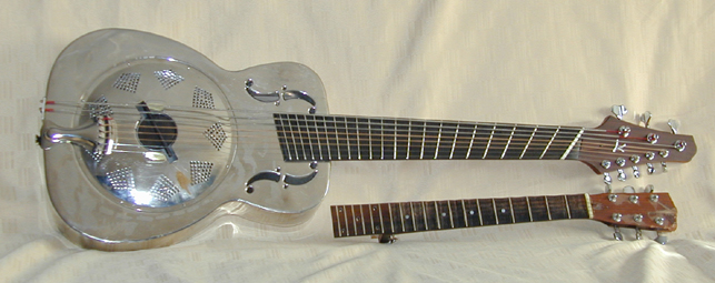

So .... A local jazzer who has an 8 string electric wondered if I could change his 6 string reso into an 8 string multiscale, ala Charlie Hunter. I said, sure why not !!!
So here it is in all its glory, finished, set-up and delivered today. I created a completely new neck, 3 piece, mahogany with a 3/16 wenge centre strip. two 1/4 x 3/16 Cf bars and a 2 way truss rod. If you have never seen how a reso neck attaches to the body, its fairly bizarre - there is actually a chunk of maple that is dowelled into the heel that then goes into the body all the way to the end, and the tailpiece screws into it. The bottom of the cone well also screws into this piece, and then there are in this case, three screws into an internal piece of baltic ply under the fretboard extension. The bottom scale is 29 inch, the top is 25.75. The striaght fret is somewhere atround 12, but the scales had to be calculated and laid out from the biscuit bridge - it was the only way to do it.
The onwer was blown away Monday when he came over for a quick try out to see how hte neck felt, and then I put a quick wipe on poly finish on and did the final setup. The saddle had to be lengthened a bunch, and I reinforced it by tripling its width above the biscuit. Its very solid. The nut had to be made from two acoustic saddle blanks CA'd together, and the width is about 2 5/16+.
Amazingly, the bass sounds pretty strong, and hte tone is even across the spectrum. The guitar overall is very loud, and sounds amazing in this players hands. He is off with it now to get used to the size of the neck - he also has an 8 string electric, but its a plain old 25.5 scale straight fretter. Oh yeah, the strings are tuned low E, A D, (105, 90 and 75 gauge) then its a stock A to E guitar tuning with medium phosphors.

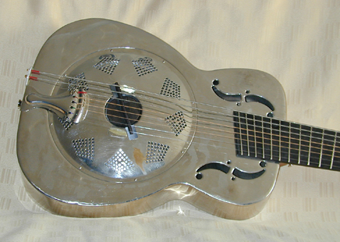

How about a close-up of the cover and saddle? I can't
tell whether you cut a slot in the cover or if the saddle
is cantilievered above

Here is the closeup of the front .. I had to cut the original saddle cover off, then grind out slots at the 30 degree angle I set the saddle at in the FB calculations. Jason may get something fashioned up, but with his technique, he never really touches the saddle anyway. So its the same old reso setup, just longer and at a 30 degree slant.
BTW, it intonates very well, I had to figure that in when calclulating the fret slot loactions on each scale, top and bottom.

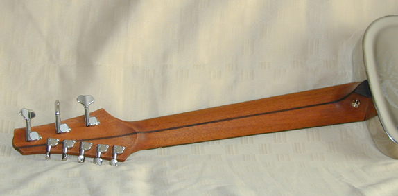

Here is the back of the neck. It was finished in Minwax wipe on poly, satin finish, about 6 coats, the third or fourth was put on with 400 grit paper. Then cure for a day, then 0000 steel wool the heck out of it. It is smooth and completely drag free. The absolute easiest satin finish ever, and has a nice color to it as well.

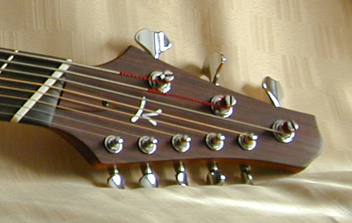

For those who havent tried the multiscale thing, something to keep in mind during the design phase - the headstock is flat, but angled down on the treble side - I wish I had thought to take a shot of this, maybe this week when it comes back for a little more setup tweaking now that Jason has had a couple days with it. So what you need to consider is to make the neck blank up at the headstock thicker around the nut area, down to the end of the headstock. The more severe the nut angle, the more thickness you will need to keep the headstock from thinning out to much, leaving you high and dry in need of more wood up there! On this one, in order to not thin too much, I left some of the fretboard beyond the nut, thus decreasing the effective tilt angle on the headstock (this is the tilt from side to side, not the original down angle which in this case was about 10 degrees, which it still is on the bass side only) I then tapered the remaining ebony down on the treble side to match the headplate thickness, and to let the higher strings stay above the wood there. It worked out fine.
